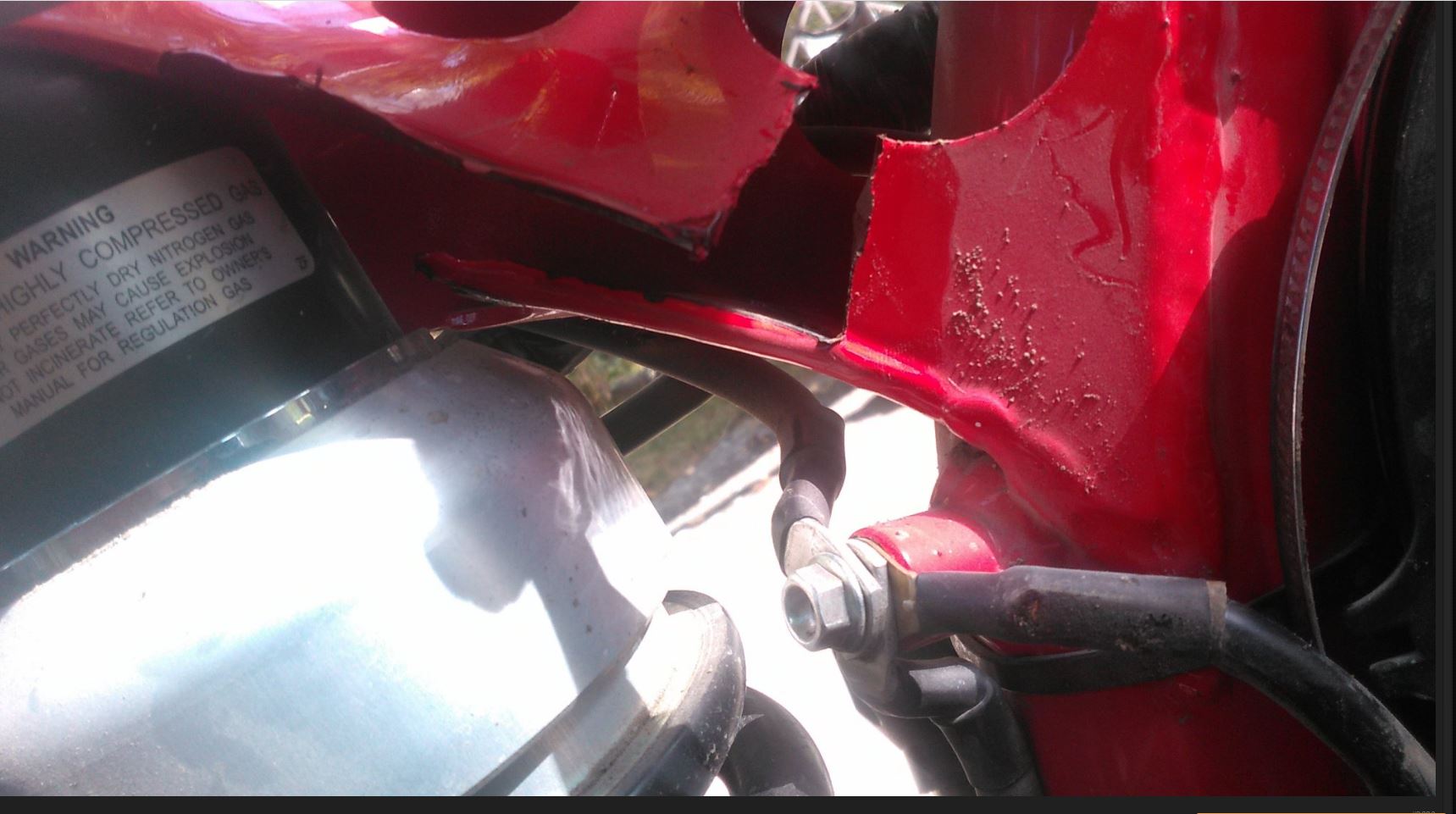

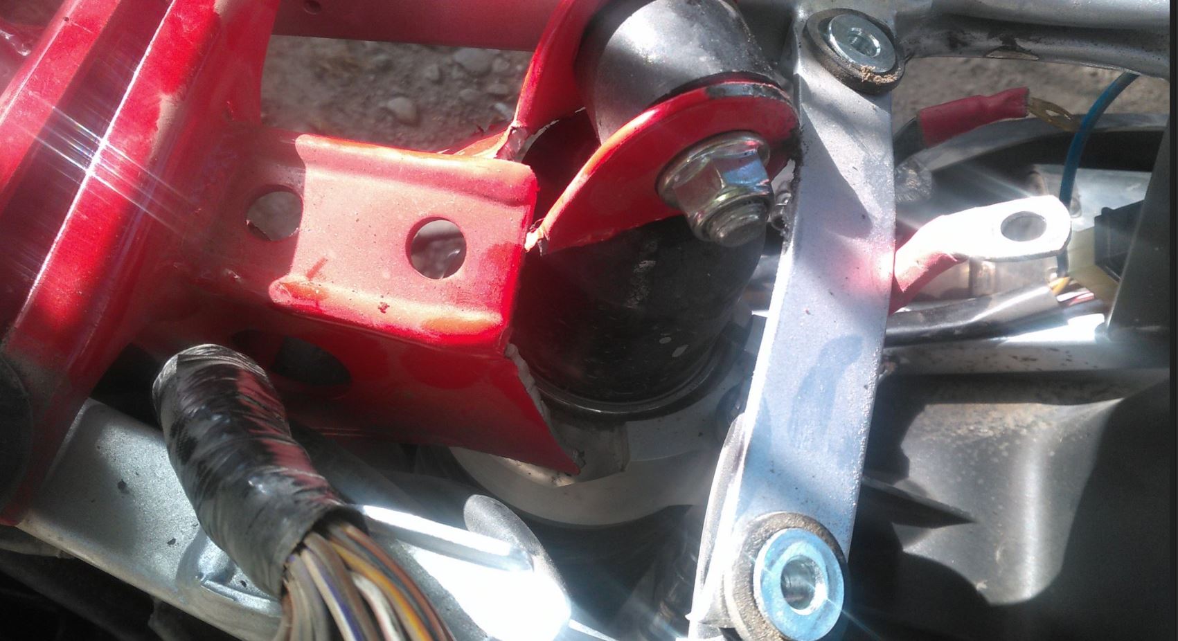

    • 14.000 Frame broken at top mound for rear suspension. Part is badly designed. Make sure the nut is not tightened Zoo much and hence creates 3dimensional tension.
      Solution: professionally argon welded in Windhoek with 2 enforcement plates.

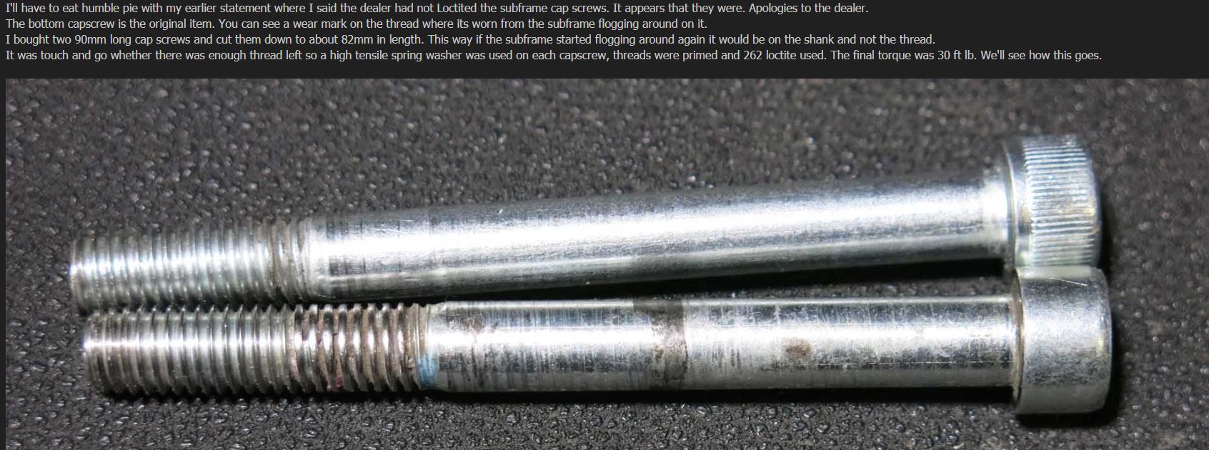

    • Braking of bolds that hold subframes. This is THE BIGGEST DESIGN FAULT of the entire bike. We even changed from 6mm to 8mm and the still broke. The guys were riding with the SWM luggage system. Not overloaded.

    sei bitte so gut und stelle noch ein paar Fotos ein. Speziell Rahmenbruch und gebrochene Bolzen. Also bei welchen das genau passiert ist.
