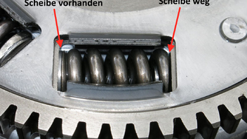

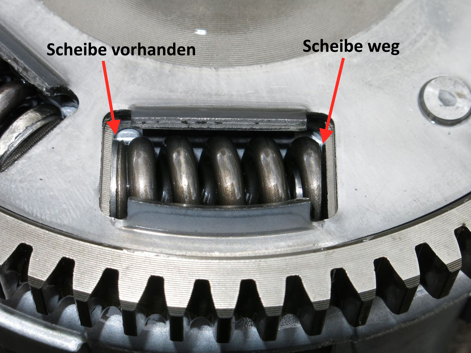

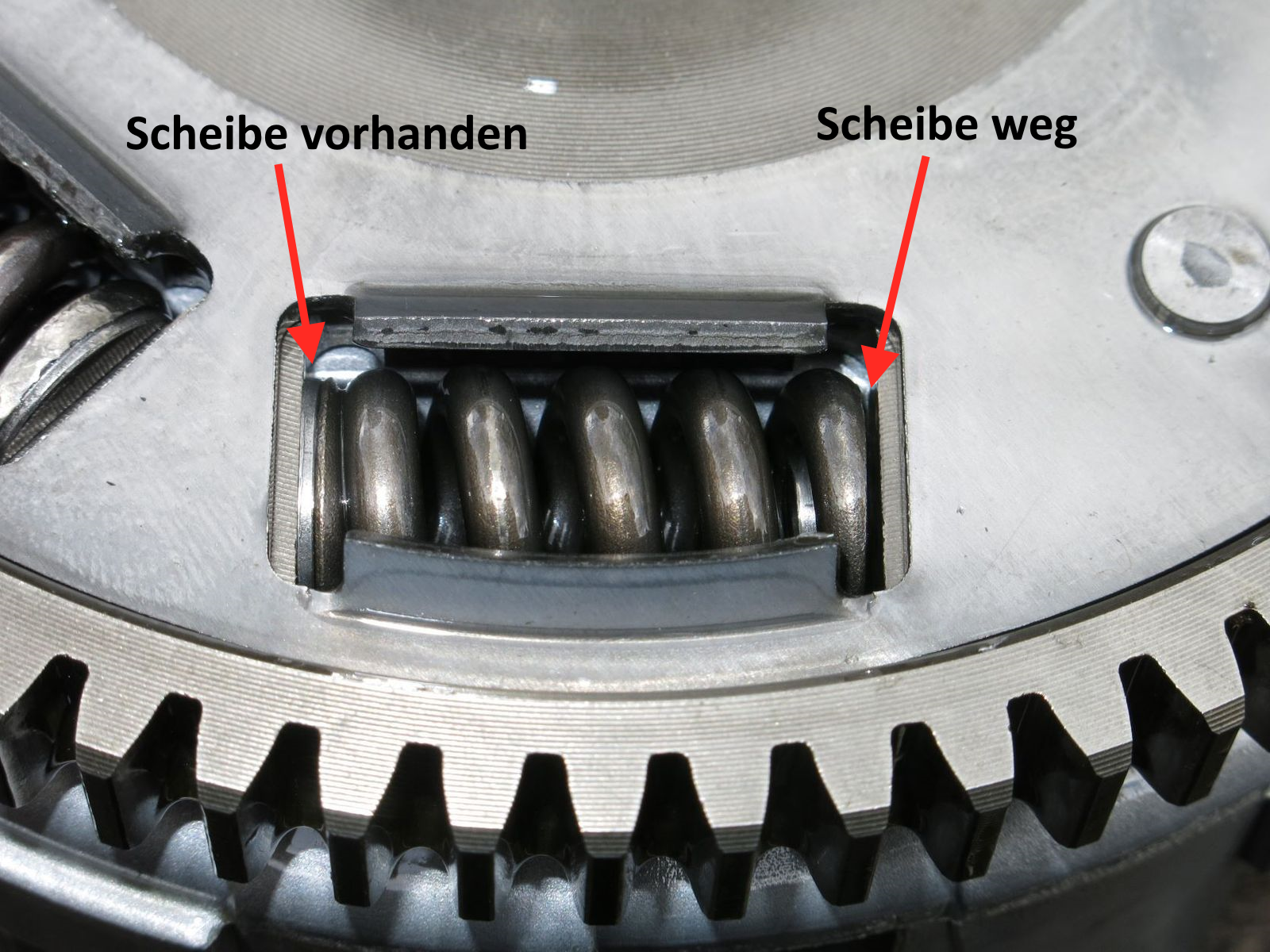

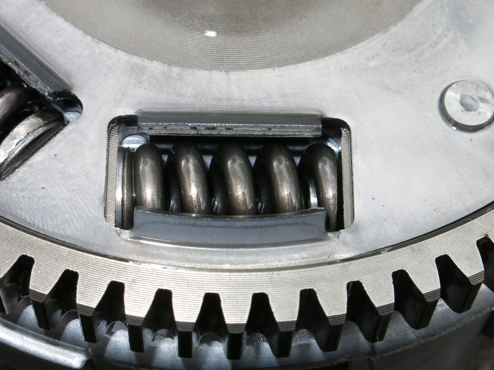

    Wenn ich es richtig verstanden habe, dann sind die Kupplungsfedern an jeder Seite mit einer Scheibe unterlegt.
    Eine davon hat sich auf Wanderschaft gemacht und dabei auf ihrem Weg ins unendliche Nirwana im Grunde den gesamten Motor in einen mechanischen Trümmerhaufen verwandelt - Getriebe, Kurbelwelle und Kolbenbereich exenziell zerstört.
    Auf dem Bild kann man erkennen, daß rechts die Scheibe fehlt.
    This picture was borrowed from cafe husky. The washer on the left is stock and the modified washer is on the right. The modified washer is made thicker on the end, 2mm, and has a longer boss. The modified washer was made from tool steel and hardened so they did not wear out. As you can see they cannot fall out but do wear out. I always wondered why there was so much metal in the oil filter. Now I know.

    Thx for sharing those pictures !
    It seems that there is a serious issue with those washers - if the SD has those standard ones.... Can you post the link to the husky forum page? Maybe I can get the dimensions of those washer so I can machine them (at least I'l try :-D)
