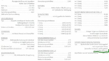

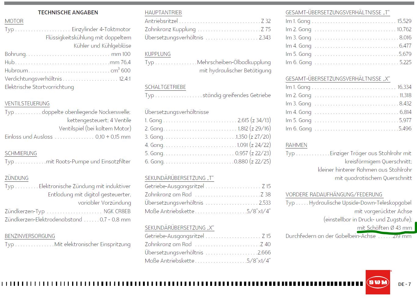

#6 It seems my dealer has this wrong.
http://powerhousemotorcycles.c…/serco/SKFKITG45M#content
Fastace forks are 43mm.
Sorry for my mistake.
